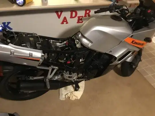

I was riding and my bike turned off at random and no car jump will jump it. I turn the key and there is no power at all. I have a fuse checker from my truck and I get no light on any of my fuses. When I plug my batter into my charger it says full. I get absolutely no electric power. All my wires look fine. I get nothing when I turn the key. Please, anyone help. I have not ridden my bike in a while so I think it’s the battery but I want here what you guys thinkenter image description here

Followed the cable to my ignition switch and turns out it had unplugged.
There are two things to check:
1) The connection at the battery. The cable could be lose or corroded. Mind you, it would have to be really badly corroded to have no power at all.
2) The main fuse. Sometimes there is a main fuse between the fuse panel and the battery. It may be attached to a relay. If the fuse was missing or blown, it woul stop the flow.
If both those are fine, it may be the ground. Try using a multimeter to track where power exists and where it doesn’t. Attach the ground lead straight to the battery and see if you have power at the fuse box.
