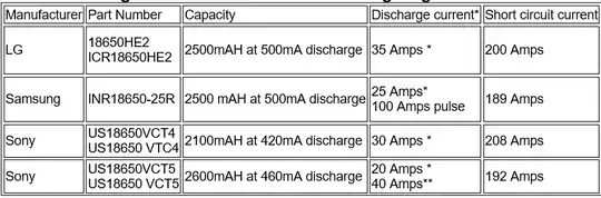

Firstly: Of course the batteries can supply current far beyond the datasheet recommended levels. However, it may be dangerous (risk of fire or explosion) if the condition exists for too long. Reference to for example an 18650 battery shows it's capable of 35+ A for a considerable period of time. Reduce the period of time and tolerate a terminal voltage drop and you can obviously draw more current as shown below: From this web site.
Secondly: The starter motor in a car does not draw hundreds of amps continuously.
Like any motor with a load, it initially draws enough energy to get the engine rotating, but as it overcomes the inertia, the current will drop. It may take only a few seconds (especially with fuel injection) to start a modern car engine and the critical parameter is that the terminal voltage should not drop below that required to run the electrics.
Clearly drawing very large pulses of current for longer period of time will shorten the life of the Li-Ion cells. You also need good mechanical connecting pressure and wire sizes to carry a large current. It's doubtful that you'd need more than 200-300 A peak to start most modern vehicles, so decent size Li-Ion batteries should be viable.
