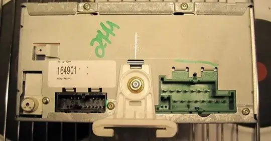

I need to replace a radio-cd 6006e and I need the ISO adaptor. I don't know what is it or where to find that information.

Take note that the orange and black sockets are connected into the green radio socket, one on top of the other. The radio antenna have their adaptor too.
