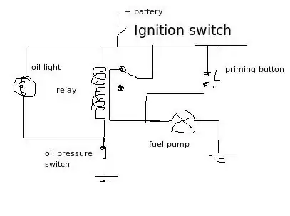

Fuel pump wiring diagram
You can achieve what you intend to quite simply by using a relay to which you attach the trigger +ve pin to the ACC/ON ignition feed and the trigger ground pin to the oil pressure switch. This has long been the method of wiring up solid state fuel pumps in race cars so that should the engine stall, they will not run.
The attached diagram shows a circuit where a fuel pump is connected in this manor. You'll note that this includes an additional priming button to manually prime the fuel lines prior to starting the vehicle. If you never need to have your device running with the engine off, you can omit this circuit.
