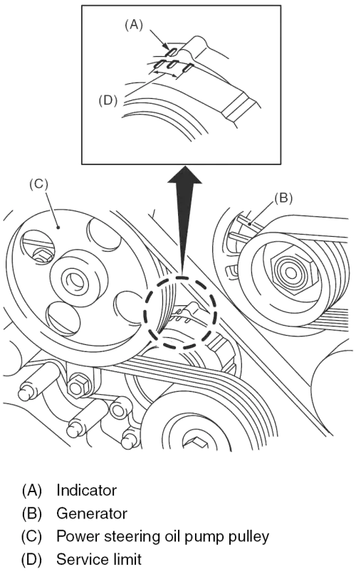

If you have the 6 cylinder you can check the status of the belt as indicated below, if it's at the service limit you should replace the belt.
