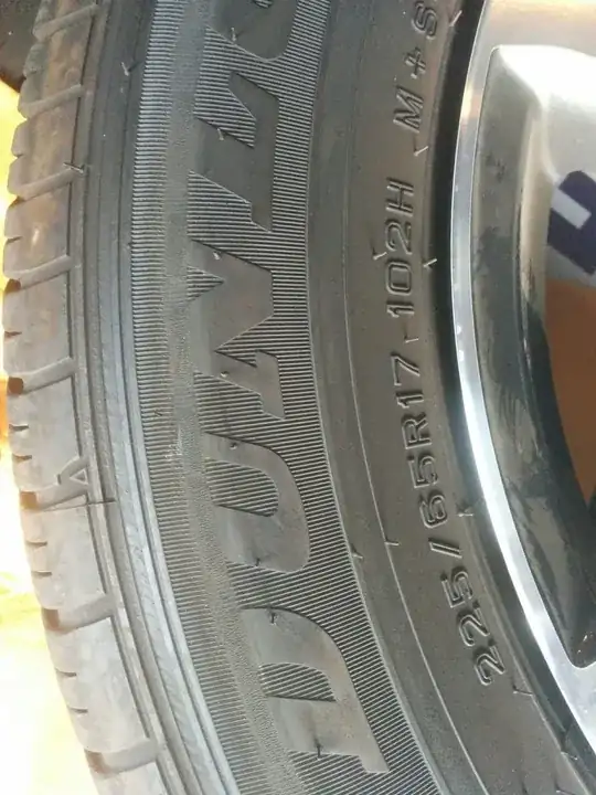

!since I had to drive to go the shoulder this damage is a circle on the tire
here is another image.

Driving on a flat flexes the internal cord far more than it was designed to take, so the tire casing is compromised to an unknown extent. If you only bop around on surface streets at 40 MPH, you could probably stick with it, but I would not want to run it on a 20-mile freeway commute. A blowout at speed could damage your $$ wheel too. I would make my decision on this and whether a loved one drives that car. Your car may require both tires on the same axle be replaced together, so I understand this can be costly. If so, keep the "good" old tire for the rainy day when this happens again. If you decide to run with it, keep an eye out for any sidewall distortion, bubbles, or pressure loss for the life of the tire.

I dont' want to be sued. However if that was my tire I would drive on it. The sidewall is only abraded a little. Worst case scenario is it starts to leak some day (incredibly unlikely). Why did it go flat in the first place? Sounds like it has other problems though.
