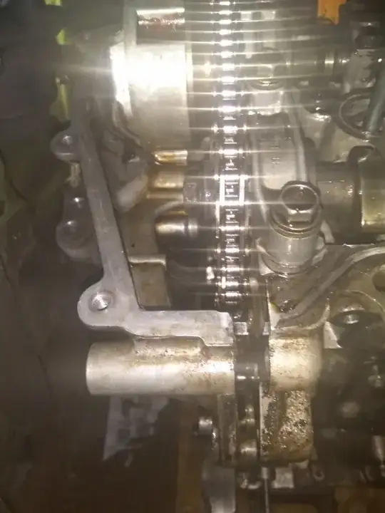

Gap between cover and engineCover I have a Daihatsu Charade with a 1KR engine with a blown head gasket. I have loosened everything on the timing chain cover but I cant get it off. It moves a lot but something seems to catch near the crank at the bottom of the cover. Any assistance would be greatly appreciated.

You must remove the oil pan (Sump) as the oil pick up is jamming , there for it will not come out
