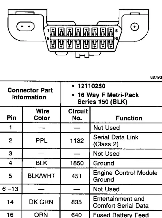

Here is is the OBD2 port pinout, a bad ground will prevent communication, pin 5 is a ground. See if it has a good ground. Key off and use a good 10 megaohm impedance ohmmeter to test the pin 5 to ground. If no ground the circuit is broken somewhere between the OBD2 connector and the PCM
If the ground is good then it is either a bad connection on pin 2 back to the PCM or a Bad PCM itself, which I suspect is the problem.
