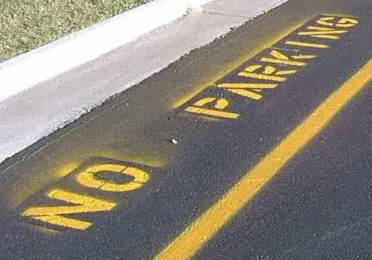

It ABSOLUTELY can. It's called overspray. Take one look at a bad paint job and you'll know it's a real thing. While not a car, take a look at this image:
Imagine how they do this. They put a stencil down and spray their spray can at the openings in the cardboard (or whatever the stencil was made out of). You'll notice there is yellow spray paint above/around the border of where the edge of the stencil. For the most part, this is overspray.
