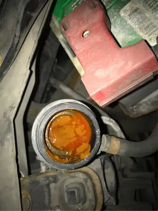

This is what the top of the radiator looks like. enter image description here

Ive owned 3 3800 powered vehicles. First thing you need to do is get rid of dexcool. Completely flush it out and refill with distilled water and add some preston cleaner or TSP drive the car for about 3 days then drain then refill with water idle until warm cool down drain. Then refill with green antifreeze and don't forget to bleed the system there is a small 8 mil bolt on top of the thermostat housing. Once you have this done change your thermostat to a 180 degree thermostat. You should see a cooler running car unless in stop in go traffic during this time it will still climb to 190. Also 04+ grand prixs do not have coolant temp sensors located on the radiator.

yeah sometimes it's your coolant temperature sensor that's on the outside of the radiator maybe you could unscrew it clean it off and put it back in don't forget to put the white pipe dope around the threads additionally I think your coolant looks pretty funky it doesn't look very clear looking looks kind of cloudy you might want to change your coolant but it could just be that your temp sensors clogged with a bunch of junk around it so it's not very accurate?
