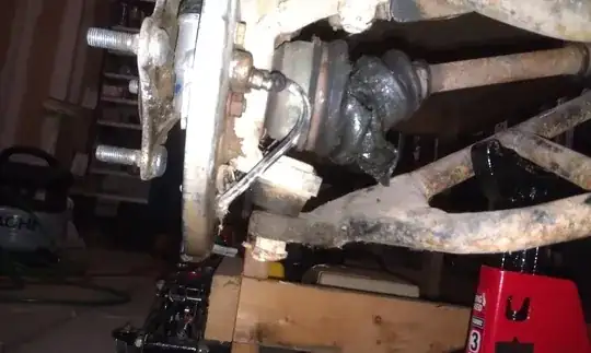

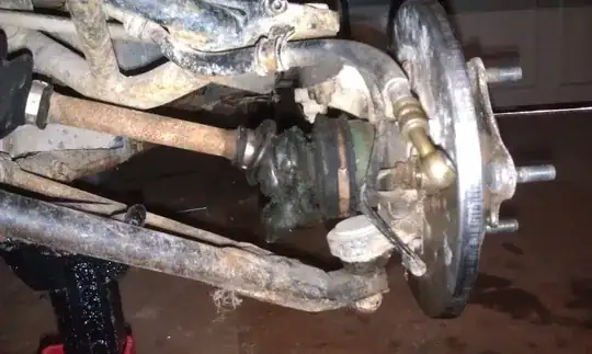

I'm working to rejuvenate a 93 Honda FourTrax 300 4x4, that's been stored in a garage under piles of junk for the past 15 years. I've got it running, and have turned my attention to the torn left front outboard CV boot.
I picked up a replacement boot, but to install it I have to remove the front axle (which is something I've never done). What do I have to do to remove the axle?

I can't speak to specifics for your ATV, but the basic process for removing an axle is:
  1. Take off the nut holding the axle in the wheel hub. I do this with a large socket wrench/breaker bar.
  2. Remove the lower ball joint from the lower control arm (see the bottom middle of your second photo). This can be difficult, and lots of the methods people suggest will destroy the ball joint. Instead, try this method: http://www.youtube.com/watch?v=hJR77aN-MDk. You might need to vary the shape of the tool you insert to work with your vehicle, but the concept should work.
  3. Lift the hub to free it from the lower control arm, then slide the end of the axle back through it (a hammer can help) and swing the hub out to the side to get it out of the way.
  4. Remove the other end of the axle from the transaxle/differential. On my vehicle, this is accomplished by prying behind it with a screwdriver. Look closely at what you're doing and be careful not to jam anything in where it could damage something.
Installation is generally the reverse of removal, but there are a few caveats. You might need some force to get the new axle to snap in, but you need to make sure you don't pull on it or you could separate the CV joints. And when you reattach the ball joint, make sure to use a good cotter pin. I once had one fall out or break off and I lost the castle nut while driving...wasn't fun.
