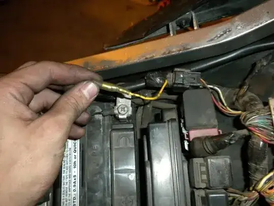

Step 1
Pull off your seat and near the battery negative terminal there will be a self diagnosis lead coming out of a connector. The wire is yellow. It looks like this.
Step 2 Get a wire, one with alligator clips on either side is what I use. Makes things a bit easier.
Attach the alligator clip to the yellow wire.
Step 3 Turn the ignition switch to the 'ON' position and wait a few seconds for the start procedure to complete.
Step 4 Attach the lead to the batter negative (ground)
Step 5 Watch your FI light. It will begin to blink long and short flashes.

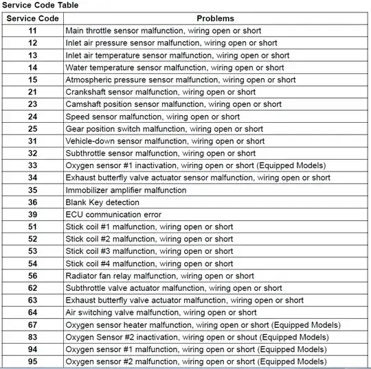

Step 6 You will now interpret the flashes into a numerical value using the following table.
Interpreting Error Codes
The FI light will be flashing long and short blinks.
The long blinks represent 10 through 90.
The short blinks represent 1-9
If you get three long flashes followed by 4 short the error code would 34 and you can reference on the table.
