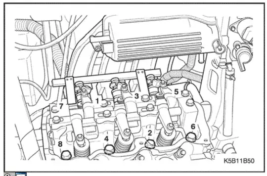

65-70Nm (48-52ft lb) - As seen in the workshop manual for that engine, here https://www.autocats.ws/manual/chevrolet/tis0808/EN/documents_2006/Matiz/sm-m/6M2_1B12.en.html#M1B1CHG. Note also the tightening order, as per this image from that site; enter image description here
