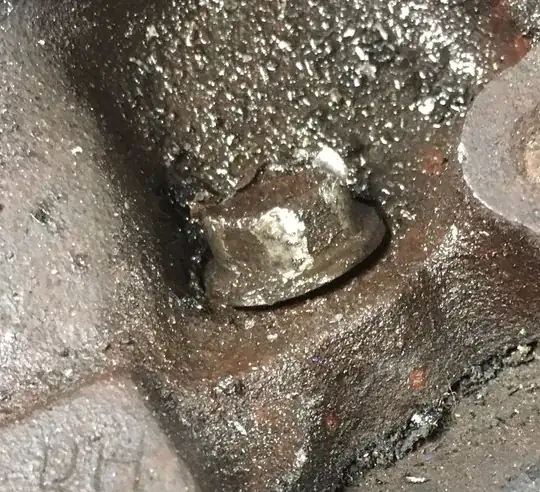

enter image description here!
I just removed a stuck, hard to get to, rounded off bolt from a rusty 350 manifold using a trick my dad showed me many years ago using a chisel and 5 lb ball peen. Put the chisel on the top of the bolt head at an angle and whack it with the hammer to back it out of the hole enough to get vice grips or something on it. You have to chisel the bolt head straight on to get a bite at first before angling it. It was slow but worked great!
