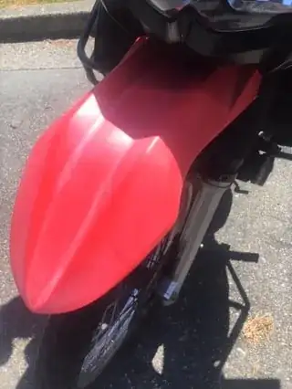

What's a safe way to remove wax from a plastic motorcycle fairing? I may have used an inappropriate cleaning product in the past, and UV may have made it worse.
side fairingsfront

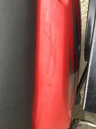

I can remove some of it with friction (photos show traces left by fingernails), but I'm just tossing it around for the most part. Dishsoap doesn't do anything. I'm thinking maybe a kitchen vinyl de-waxing cleaner might work.
Once clean, I might try some of the rejuvenation solutions mentioned below. They're not quite what I'm looking for however.

Update:

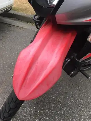

I've tried a scotch brite, "VIM Linoleum and Vinyl kitchen floor cleaner" in hot water, and elbow grease, and I've managed to make some of it go, but It's a marginal improvement -- it looks slightly better, but that's because it's a sunny day and the photo is washed out a bit.
slightly better
After vinyl kitchen floor cleaner. a tad better

Hard to say for certain what will work without knowing what the substance actually is - washing up liquid is normally pretty good for stripping off most waxes, but as you say it's not done the trick here. You could stay on the same tack but up the firepower a bit by going with something like Meguiars Super Degreaser - I've used this to clean polishing pads before so it definitely can shift polishes and waxes.
You can try it at 10:1 dilution initially and if that doesn't do the trick you can take it up to 4:1.
If you do go down this route then you'll want to make sure you rinse the paint work off thoroughly afterwards and ideally apply an appropriate protective layer of a suitable sealant afterwards.
It's a bit annoying to purchase a gallon of stuff to just clean one fairing though (especially given it's not exactly cheap!). Although you can of course use it for when you want to clean engine parts etc in the future.
Alternatively a good tar remover is worth a try AutoGlym Intensive Tar Remover is very effective for taking tar (duh!), tree sap and glue residues off paintwork without damaging them - so it might work on whatever is on there. It's just hard to say without knowing exactly what it is!
If that doesn't shift it you could try using a claybar - you'll want to make sure the paintwork is free of any loose dirt before hand (a regular wash with any car shampoo that doesn't contain wax or even washing up liquid is fine) and then rub the panel with the claybar (taking care to keep it lubricated with quick detailer). I've never tried a claybar for this sort of job but can see how it might work.

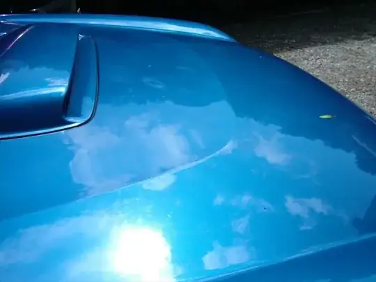

I don't know enough about the VIM Linoleum and Vinyl kitchen floor cleaner to know what that will have done but the scotchbrite was ill advised to say the least. That's way, way, way too harsh to use on automotive paint. Sorry to say it but the chances are you've done more harm than good with that.
I appreciate that this may be a little too late in your case but for the sake of future readers:
NEVER USE A "SCOTCHBRITE" OR SIMILAR ON AUTOMOTIVE PAINTWORK
The course nature of these causes lots of fine scratches in the clear coat. Here's what one of my cars looked like after a previous owner had done just that:
Poor Subaru
You see the little circular scratch marks? Yep, done with a scotchbrite-esque scouring pad. And that picture was taken after the car was cleaned, it had been throughly washed and clayed at point - that's the bare clearcoat you're seeing.
All the fine scratches the scourer makes light hitting the clear coat refract at lots of different angles giving a unpleasant cloudy effect to the affected section of paint.
That little disaster took ~2.5hours of grafting with a machine polisher to rescue.
I don't know whether it's going to be that bad in your case - I'd need to see some decent close-ups to know how bad it is. The layer of whatever-it-was may have helped protect the paint, or perhaps the lino cleaner offered some lubrication protection of it's own. Or perhaps it's f##ked.
