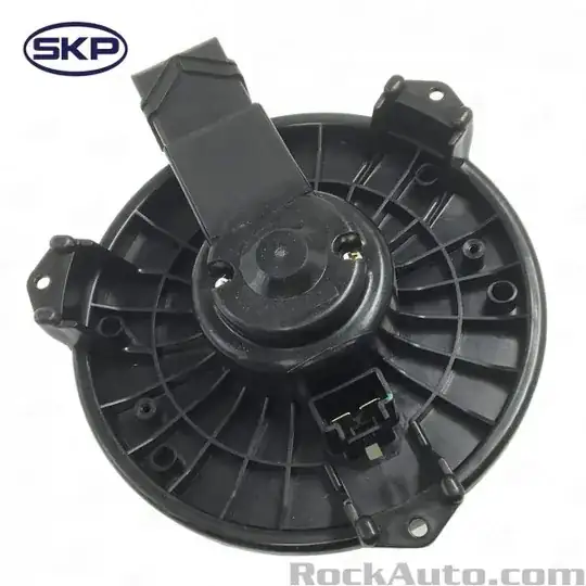

You can probably pull the fan out and take a look, but it will take a little digging to get to it. Something is interfering with it, that's for sure. The bottom of the blower motor looks something like this:
You can usually get to it from the passenger side foot well. The three screws will take it down, then you can see what is interfering with it.
