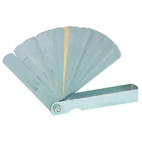

  1. I lined up the camshaft sprockets with a feeler gauge, since I needed a thin straight edge and you can bend it to a 90 degree angle to get in the tight space and still see it line up when you look directly on.
  2. I started the timing belt on camshaft sprocket 1, then 2, then put a all purpose clip from Harbor Freight to hold the belt in place.
  3. Last of all I held the belt in place when I pulled out the timing belt tensioner pin and then rechecked everything again.
Below is a picture of a feeler gauge for illustration: enter image description here
