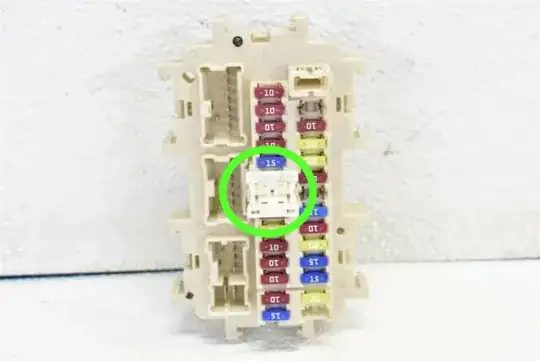

In some models of the 370Z, there is a transport / storage switch in the interior fuse box. It's meant to reduce battery drain when the car is not being used by a driver. It cuts power to the obd2 among other things but not anything vital so you wouldn't notice it from daily driving.
When I was checking fuses earlier, I had pulled out this switch just a little and not pushed it back in all the way. Once that was pushed in, the Bluetooth obd2 device was detected properly.
