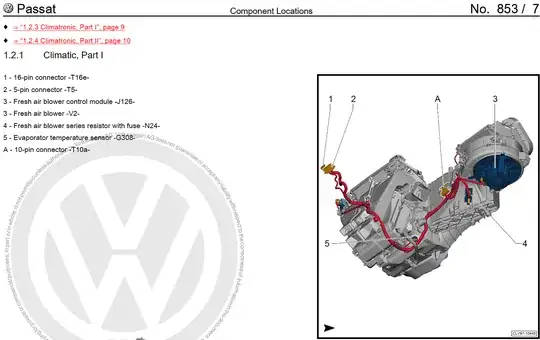

My 2012 VW Passat has dual AC zones. The passenger side AC is not blowing cold air. The Driver's side does. in my slow debugging routine, I am looking at the Wiring Diagram, but I cannot figure out how does the driver and passenger side AC temperatures get disconnected?
The issue I am facing is:
  • Driver side can blow either hot or cold air. The passenger side seems to blow only fan or hot air.
  • There is a mild grinding (not sure how to describe it) sound when I turn the AC system on.
  • The AC exhibits the same behavior whether the Sync is ON or OFF.
  • If the Sync is OFF, and I turn the passenger side to MAX heat there is a single "click" sound (only when it almost reaches the MAX temperature).
  • It does not matter if I am settings the air direction to the Cabin or to the foot area, or both.

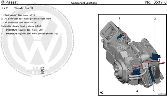

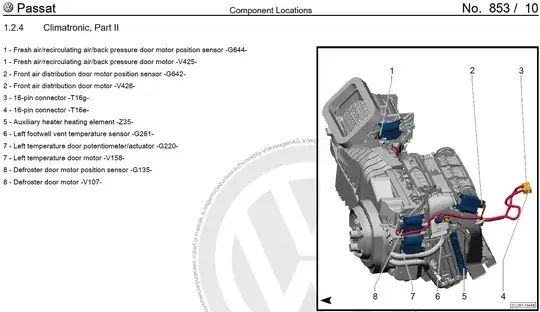

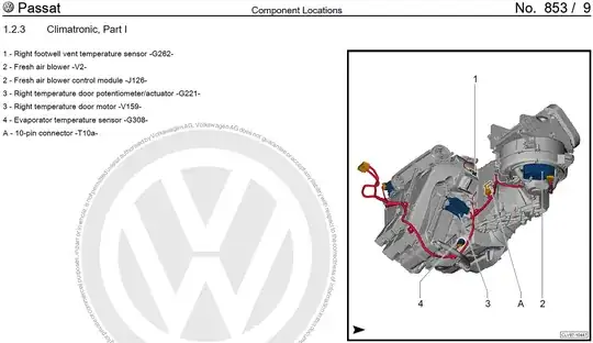

This makes me think that the Recirculator Flap Motor (or as it seems to be called Air Distribution Door Motor) is at fault. But I am not sure which motor needs to be replaced.

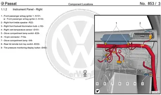

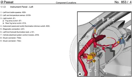

Below I am attaching the relevant diagrams:
enter image description here enter image description here enter image description here enter image description here enter image description here enter image description here

I'm nearly positive in that system, there are two temperature blend doors, one for drivers side, and one for passenger side. The mode controls (where the air comes from, floor, panel or defroster grill) are common to left and right. Ditto for the single recirculation door.

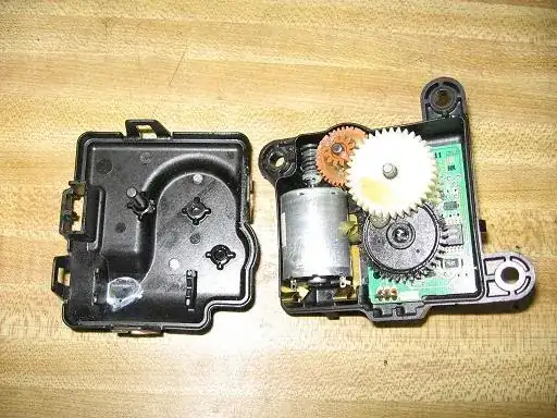

It's very clear to me that the passenger side temp controller is not working as intended. It's possible that the actuator has a dead motor. It's possible that the actuator internal gears are stripped. If that is the case, it's a pretty easy repair. These electric/ gear driven actuators move a plastic door, varying the quantity of air going thru the heater core. Remember in your system, engine coolant ALWAYS flows thru the heater core. But here's the bad news. It's also possible that the plastic air control door is stripped / stuck. The actuator drive link fits inside door. I've seen doors get split at that point. If that's the case, you will have to remove the air handling unit and repair the door. It's not an easy repair. (Drain A/C refrigerant, drain engine coolant, remove instrument panel, etc...)
temp door actuator
How mechanically inclined are you? Here's a quick test to confirm the specific fault component. I'm guessing if you remove the glove box, and place your hand on the passenger temperature door actuator during vehicle startup you will feel a vibration while the internal parts are in motion. If you change the passenger side temperature while the system is on you will feel the same vibration / grinding. Note, you do NOT need to have the engine running for this test.
In my experience, the most common failure is plastic gears internal to the actuator getting a tooth or two stripped. In the photos you provide, you will be looking at the Right Temperature Door Potentiometer/Actuator & Right Temperature Door Motor. Not sure where you are located (Auto Parts Suppliers?), but if it's just the actuator, the parts cost is pretty reasonable, likely in the $50 USD range for this vehicle.

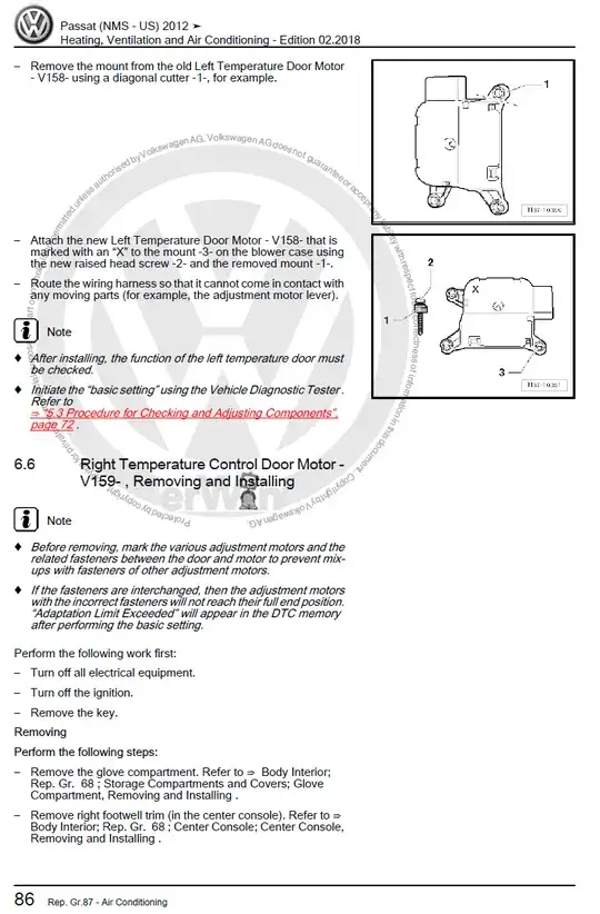

For both cases #2 and #3 you will need to remove the passenger side glove compartment. According to the Heating - Ventilation and Air Conditioning manual on pages 86-87 (section 6.6), you have to:

At this point, you can check if the handle/pin are loose from the door. The handle is the RED piece in the first two diagrams of this answer. There is a white "hand" that is connected to the motor itself (see in the pictures below), then there is a two-piece black "hand", one end connects to the white "hand", and the other end has a roundish finish (pin) that goes into the door's hole:
First thing to do at this point is to check if the hands are loose from the motor or from the pin. You can turn on your car, and adjust the AC from MIN to MAX temperatures, you should see the white hand moving the back hand.
Relative positions are marked as follows:
  • LO the white hand is towards the cabin.
  • HI the white hand is towards the engine.
Make sure the hand is moving, and that it moves the whole black hand, and that the black hand is placed within the pinhole. At this point, if it is loose, just pop it back in. Done.
As far as I remember, when I tried it - the white hand did not move. But when I have released it from the housing (un-mounting the 3 screws) - it worked find. You will have to debug the hands, and motor.
To remove the motor: just unscrew the three white screws (used a size #6 socket), and then remove the power cable.
Check if the motor is moving the white hand when not mounted. It may move freely now.
One thing I learned is that the motor may seem like it is seized and wont move when you try to move it with your hands - but that motor is well fixed, and will resist your hand/manual force - it does not mean it is seized.
Note: Without the motor holding the door, the passenger side constantly blows cold (LO) air. Great for the summer days, not so much for chill evenings and cold winter nights.
Second thing, the passenger size motor is called V159. I had an unpleasant experience ordering it from the dealership. They charged me $170 for it. Ended getting it from AutoZone online. They do not carry it in the store. Paid $134.29 after using a coupon code I found online (regular price is $157.99).
