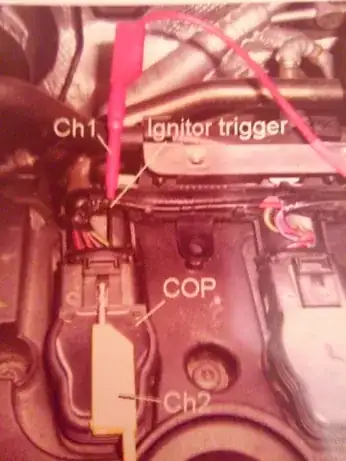

Most COP are either 3 or 4 wire.
One will be your 12V, ground (return), ignition trigger and ECM signal feedback (optional).

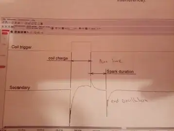

On your scope connect your black probe to the battery NEG. terminal, CH1 will go to the ignition trigger and CH2 will be simply placed on top the ignition coil.
Zoomed in you will be able to see your coil charge time and spark duration.
Good running engine should have at least 1.2ms spark duration.
