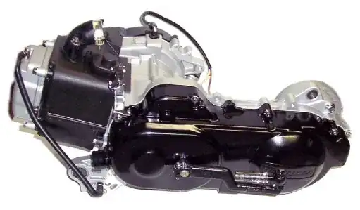

Here are some images that might help with identifying where everything should connect. I snipped them from a manual for QMB139 (GY6) that is referenced in Rory Alsop's answer to the question "Scooter Won't Start" on this site. If your engine looks like this...
Engine photo
... Then the following diagrams should apply to your scooter.

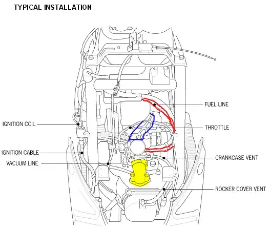

Here I have highlighted in yellow the fuel/air connection from the carburetor to the engine, outlined in blue the air supply from the intake to the carburetor, outlined in red the fuel line from the tank to the carburetor.
Engine diagram

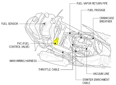

Here I have highlighted in yellow the fuel shut-off valve for the gas tank.
Shut-off Valve

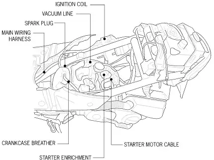

Here is another view with more parts labeled.
Engine diagram

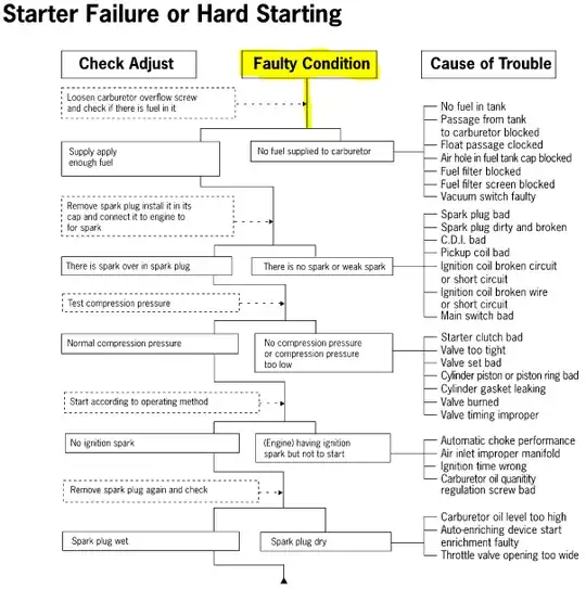

Here is a helpful trouble-shooting guide that might help get your scooter running again. I highlighted the starting point in yellow because it wasn't immediately clear to me.
Trouble-shooting

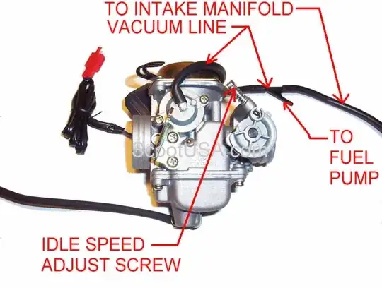

The upper hose that you found cut and zip tied is likely to be a vacuum line, rather than a fuel supply line.
scooter carb with vacuum lines illustrated (image credit www.scootusa.com)
If so, the fact that it is cut and plugged should not be causing your failure to start, it is likely an emissions-related feature that is activated when you get off the gas.
