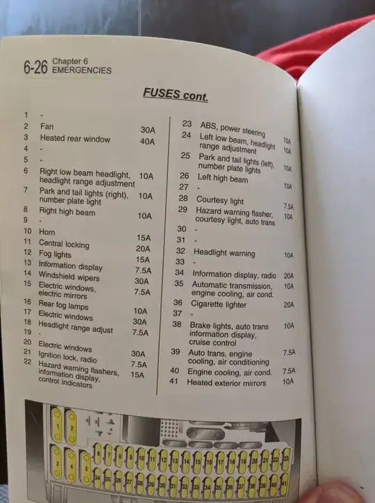

As far as I can see - the Holden Astra doesn't have fuses for the indicators themselves, see the fuse diagram from the owner manual:

The blown fuse was number 29 on the shown diagram (the inside car fuses).
The diagram says: Hazard warning flasher, courtesy light, auto trans which isn't particularly helpful, but there you go, it apparently controls the indicators and speedo as well.
