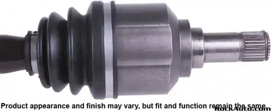

If you look to the very right in this image:
From Rockauto.com
You'll see a snap ring. This holds the end of the axle in the transmission. To get it out, you need to wedge something like a long flat tip screwdriver or pry bar in between the transmission case and axle, and pop it free. It will take a little bit of finagling, but it will pop out. Don't pull on the axle shaft itself, as you risk pulling the CV joint apart.
