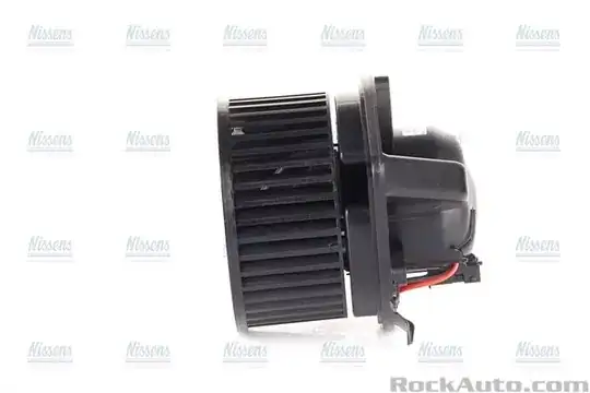

You need to check to see if there is power going to the blower motor when this problem occurs. For your vehicle, the blower motor should be under the dash in the passenger's foot well. It should be covered by a shroud. Under the shroud, you should see something like the right side of this image sticking down:
From RockAuto.com
Pull the power lead which has the two wires. Check to ensure one wire has power and the other side is able to ground. You'll need a multi-meter to do this. To properly check this, the vehicle must be on with the dash showing the blower should be running. If your test indicates there's no power, the problem lies in the control itself. If there is power, the problem lies in the blower motor. At this point, with the plug unattached, you could apply power directly from a 12vdc source and see if the blower motor is energized. This would confirm there's no power getting to it from the controls. If it is determined to be the controls, about the only way to fix this would is replacement of the control itself. Why the cold would be causing this is beyond me, but I've seen crazier things go wrong.
If there is power, the problem may reside in the blower motor. If, for some reason, the blower motor freezes up (say, the lubricant has an issue), it will no longer work until it is warmed up. The blower motor resides outside of the heating loop (where the air flows) so it doesn't overheat while in operation. This wouldn't allow the motor to warm up to the point of working, either.
To check and see if this is the issue, locate the blower motor itself (see above). Take a hair dryer or heat gun and heat it up the bottom of the blower motor. If it starts to work after getting fully warmed, my suggestion is to replace this.
