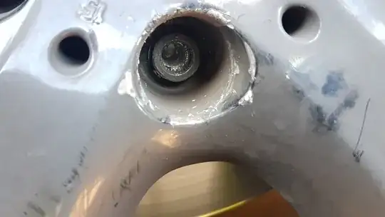

-Not my best work here. Destroyed the lock adapter, trying to get the lock nut off. Hammered a socket onto it, was foiled by the free wheeling washer around the outside. Got the socket off, which also took the top part of the lock nut off... :(

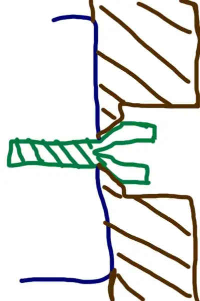

I tried drilling it - so i could pop the head of the lug off. Then get the wheel off and remove the remaining bolt. Starting with small drill bit sizes and working my way up in diameter. Got to about 9mm and the drilling couldn't get any further. Drill would either spin and overheat, or catch and lock. My dad's reckons the drill stopped working because I was reaching the hardened out part of the lug. Maybe. Bolt is 12mm diameter.
I've left two pictures here, showing where I'm at. I'm wondering if a die grinder has the strength with the right carbide tool tip to help me finish the job. Also open to any other suggestions.
-Sim Pic of drilling efforts Profile showing where it's at.
Simt

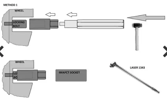

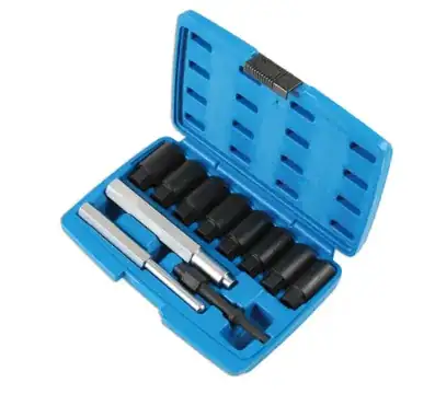

You can get tools just for this job - Do a search for "locking wheel nut removal tool"
For example this one from Laser Tools -
https://www.lasertools.co.uk/product/6972
