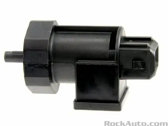

P0501 refers to the vehicle speed sensor (VSS), not the wheel speed sensor for the ABS. Some vehicles use only the wheel sensor to provide the speed, while most use two different ones (one at each wheel to detect differences for ABS and one for the actual vehicle speed). The VSS is attached to the transmission. For the manual transmission, it should look like this:
The left part is attached to the transmission while the right side has a wired plug attached to it. It should be located on the top of the transmission (which is on the driver's side for a left hand drive car).
Before you replace the sensor, though, you need to check the wiring to ensure it's in good shape. Seems the Rio may have issues with this sensor going bad due to overheating, so check it out prior to just changing the sensor itself.
