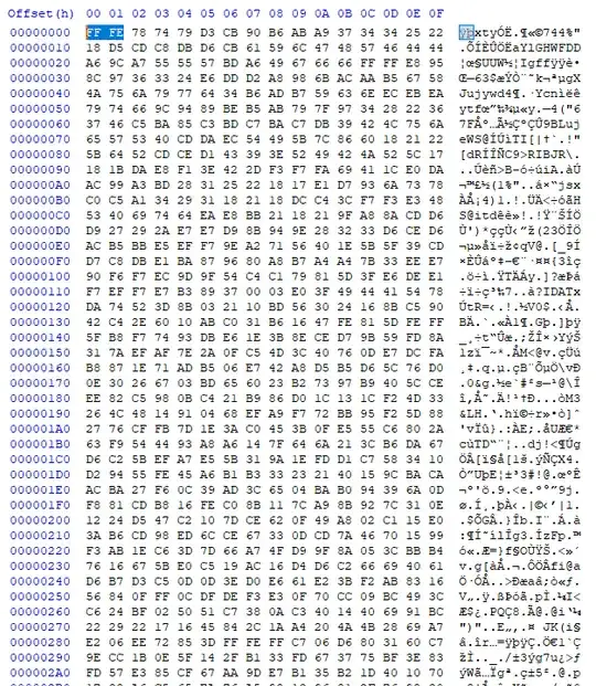

  3. Check that your MP3 files are valid MP3. Open them in a hex editor and look at the internals. A valid MP3 frame typically starts with FF FE, and on the right hand side of the hex window will be a jumble of characters. In this screenshot I've highlighted the start of such a frame: enter image description here

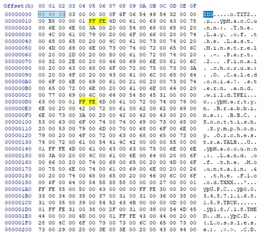

If your mp3 has no ID3v2 tag, the first two bytes in the file (offset 00000000) will likely be FF FE or FF FF. (You might also see FF FB or some other character in last place). If your file has an ID3v2 tag it will start with "ID3" on the right hand side:
ID3v2 tags also contain things that look like frame headers but they aren't; they're either byte order marks or they're a way of spreading tag data out to look like mp3 frames that are to be silently ignored as invalid frames and skipped by the player, as a way of allowing players that don't understand v2 tags to still play the files. It could be that your file has a tag and the player is choking on it. It could be that the files aren't MP3 at all. If your file has an ID3v2 tag and you'd like to try removing it there will be loads of software that can do it. If your file has none of the characteristics listed here it might be another data format named as mp3 by mistake
