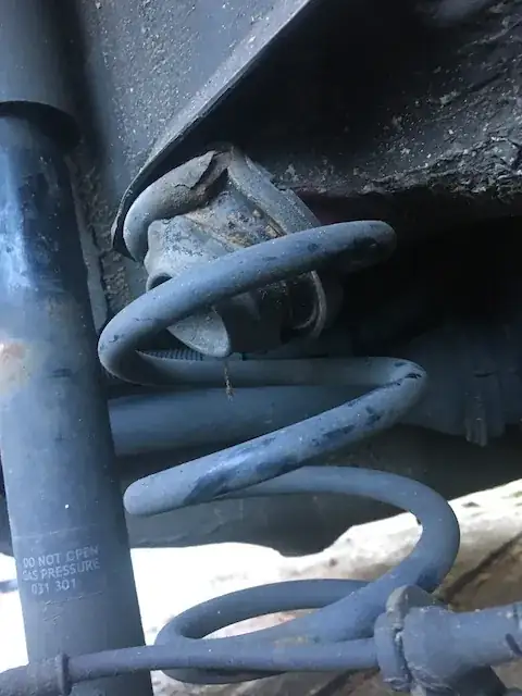

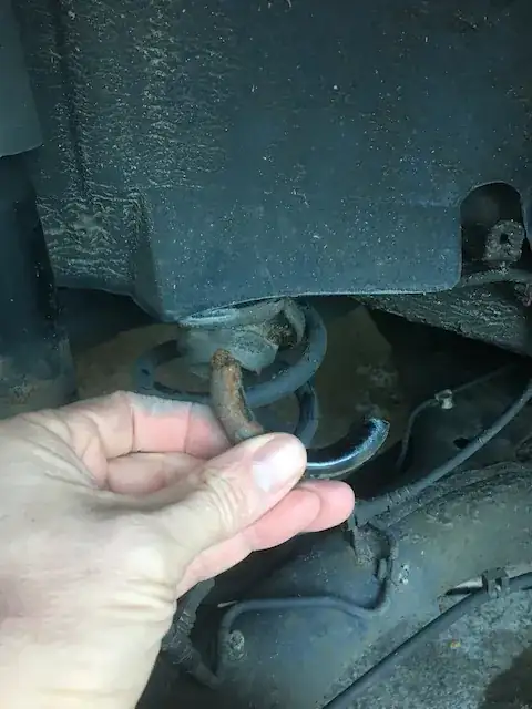

My 2005 Jetta TDI Wagon started making a "spring like sound" that was coming from the right rear corner - I pulled the wheel and found this:
Broken spring and twisted bumper
Piece that broke off of the top of the spring
I'm trying to decide if I need to "ground" the car or if it can be safely driven while I wait for parts to arrive. I figure I should replace both springs, their bumpers, and since I'm there also replace the shocks (they are probably original with 200,000+ miles on them).
Given the mileage - and the work it will take to replace the spring - is there anything else that I should be looking at / replacing? I assume it would be wisest to replace both springs.

That spring can rotate and rip out the tire - catastrophic loss when entering a bend could mean driver, occupants, other drivers, and/or bystanders could be singing with the angels...
Ground the car instantly, it is not safe.

My biggest concern with issues like this is causing additional damage since the spring is no longer being supported the way it was designed to be.
Also, the rear suspension is (obviously) compromised, handling is going to be affected.
My recommendation is to park it until it can be fixed.

The basic issue from a mechanical point of view is that the spring (not the shock!) is what supports the weight of that corner of the car. Clearly, with a piece missing, it is not doing that as it was designed to.
If the car "bounces" while being driven, the broken spring may end up further out of position and not carrying any load at all.
Personally I wouldn't drive it anywhere at more than walking pace, and avoid anything like driving up and down a kerb.

The last three quarters of a turn of the spring is flat, and coiled to a smaller diameter than the body of the spring, so that it can sit snugly around the locating nub welded onto the frame, with the rubber isolator between them. With most of the last turn missing, the spring is effectively resting on a single point. The first picture shows its proper position - you can just see a rusty circle behind the isolator that has also rolled out of position. Were the spring and isolator on that pad before you lifted it? You probably can't tell now, but the risk is that the spring becomes free to move out of position, and potentially fall out, or worse, fall towards the tire and rip it. Tyipcally, the limit of extension of the shock is intended to make sure that the spring doesn't come loose even under full travel, there's no guarantee of that now.
Al that was preventing the spring from moving any further was the now larger next coil of the spring, which was probably rubbing against the nub, and producing the sound you heard. You'd likely be challenged to even lower the car back onto its suspension with the spring returning to its proper location, but there's no guarantee it'd stay there.
I'd park that vehicle until you can get a new spring. It's just not worth the risk of using it.

Is it spring or the strut-mount assembly which is broken !!
The spring coil is placed with the rubber (and ball-bearing, if rear) kit on this mount. please confirm if the steel spring is broken or just this mount assembly?
However, if you don't change the broken coil, it would spoil shocks system on the other sides too.
