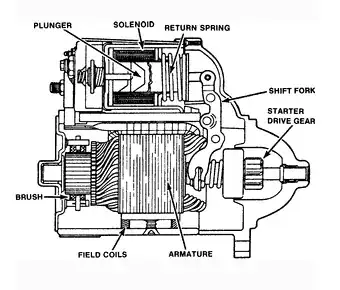

BURNING OUT A STARTER is the same as destroying it,a starter uses a lot of power when running i am talking about 100-200amps.
The solenoid pull the gear in position and connect power to the brushes,the solenoid is a high power relay,if there is a bad connection in the solenoid it might fail.
The brushes feed electrical power to the field coils,larger starters have four brushes two are connected to the output side of the solenoid and the other two is connected to minus/ground/chassis.
What your mechanic might have tried to do is to burn off oil/grease from the brushes,The problem here is that burning off oil will create carbon and this is electrically conducting so it will have a negative effect on the starters performance.
