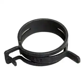

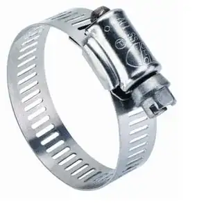

Be careful, since this is often a rubber hose and can be brittle and either crack or tear. Usually, this has a clamp on it, but sometimes it's just on there by friction. A clamp might be as simple as a squeeze type that just takes a pair of pliers to squeeze some nibs together to remove, and some are screw type hose clamps that use either a flat bladed screw driver or a socket to loosen. Also be careful to not break the plastic tank.

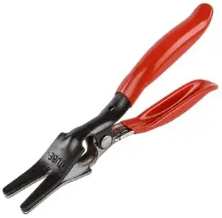

If the hose is stuck and won't pull off, try carefully twisting it, since this will break any seal between the hose and the plastic. You can also try a hose pliers, if it's really stuck.
Squeeze type hose clamp
Screw type hose clamp
Hose removal pliers
hose removal pliers
When putting the hose back on, make sure to not use too much pressure, since this can break off the plastic spout on the tank as well as damage the hose. Over tightening a clamp can do the same thing, so just make it a little more than snug, rather than really ratcheting it down. Basically, there's no fluid pressure on the joint, so as long as it doesn't leak when full, you're doing it right. The squeeze type will adjust itself, so this is more for the screw type hose clamp.
