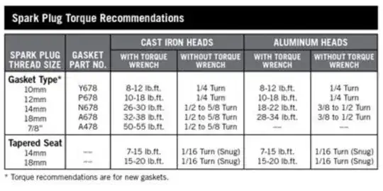

First of all, there are recommendations for plug tightening. The following chart from this website shows:
The same site states:
Tapered-seat spark plugs should be installed by hand until finger-tight. Then use an additional 1/16th turn applied with a spark plug wrench to ensure the spark plug has been tightened to the manufacturer’s recommendation for a 14mm thread. Alternatively, using a torque wrench, tighten the spark plug to approximately 7 to 15 lb. ft. for 14mm threads and 15 to 20 lb. ft. for 18mm threads to ensure a gastight seal. Overtightening a spark plug will stretch the plug body and potentially result in breakage upon removal.
For gasket-type plugs, install the plug until finger-tight. Then if the plug is being installed with a new gasket, use a spark plug wrench to apply a 3/8 to 5/8 turn – depending on head material. (See chart below.) When reinstalling a used spark plug with a used gasket, only ¼ turn is necessary, regardless of head material.
