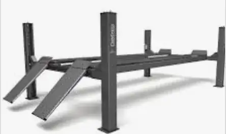

To avoid confusion for some, the type of ramp I am referring to is shown in the image: enter image description here
These are common in some countries and also used for vehicle testing in many establishments. These ramps are installed with the metal surfaces where the wheels go level, which is useful as trying to find apiece of perfectly level ground can often be a challenge, even a concrete driveway is usually constructed with a slight slope to promote drainage.
