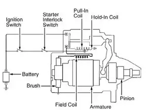

On many (most?) cars, the starter is grounded through the engine block and subsequently the chassis. For example, here is a wiring diagram for a Miata starter - there is no wire going directly from battery ground to the starter:
Miata starter wiring diagram
In theory, if you are, say, jump starting one Miata with another you could connect both chassis instead of connecting battery grounds. In practice there are three issues with connecting chassis:
