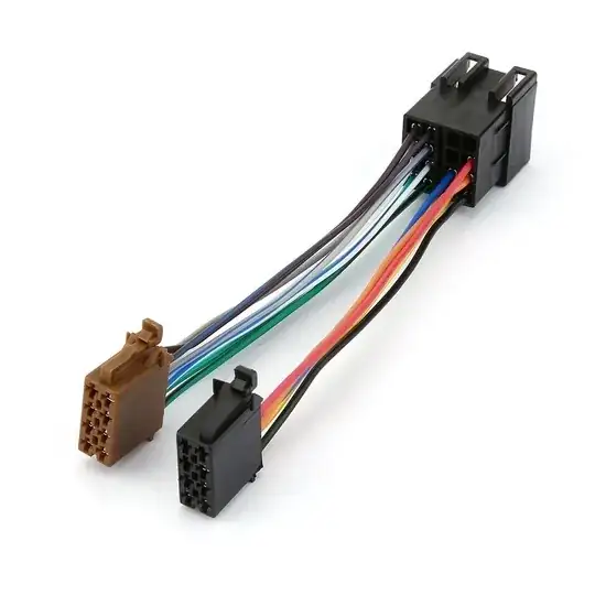

Easiest thing to check is to remove the head unit (and as much of the surrounding plastics as practical) and peer into the wiring on the car side. From the factory you should have wires going into OEM terminals. A well-done head unit install uses an adapter harness that looks like this:
If you have wires changing colors, random electrical tape, homemade-looking connections that's your cue that someone was in there and hacked the wiring.
