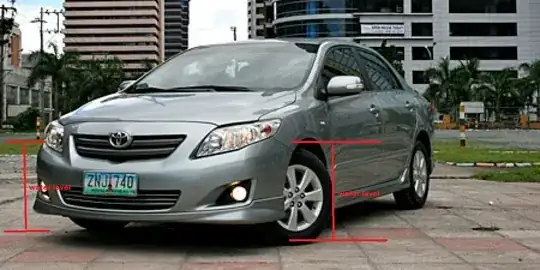

There was a day where it rained extremely hard like buckets of water at a time. It flooded like crazy in a matter of 10-15 minutes literally. The floods were insane and I panicked driving through light floods until the corner street of my destination--which I shouldn't have drove to because it had a few feet or water. It was deep probably around this level:
I know it was a mistake going through water this deep and I didn't realize until it was too late. The distance was only about 10 meters lasting about a couple seconds and I heard gurgling as I passed by the flooded street, but I had to keep going because in my head I just can't stop or my engine will die.

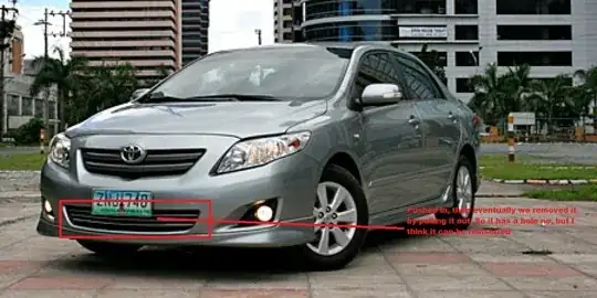

Then before entering the next street I hit a physical object that caused my front bumper going loose (near the headlights) because I had to pass by a narrow street and I couldn't see the street due to the water level and I was in a panicked state. Luckily I was able to re-attach it by hitting it in after I parked, but what I did not notice until I got home was that a plastic element below toyota logo was pushed inside the car which we later removed at home so there is a empty space in this area of the car. This is the part that was pushed inside:

My primary concern would be electronics, if they seem to be working, that is a good sign. Things like the speed sensors on the wheels to manage traction and brake control . And tire pressure. Maybe try hard braking on an empty road to see what happens. There are so many possibilities I think I would just drive it and try to be aware of any unusual responses. Two considerations ; over time electrical connectors that got wet may corrode and cause faults . And if it was salt or brackish water, all the electrical/corrosion possibilities will be worse.
blacksmith37
  • 3,743
You haven't hydrolocked your engine, which is good. I'd go as far as changing engine oil immediately, transmission (and, if it is separate module, also the differential oil). I'd also check if the radiators are damaged - specifically, if lots of ribs are bent, which will prevent it from cooling off properly. Everything else should be fine for the time being.
