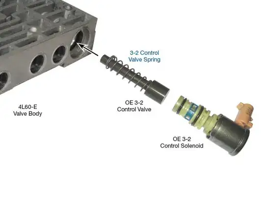

Found out what was wrong! It was my stupidity, unfortunately, but that's the goal I suppose, is to make mistakes and learn.
So the problem was, that while installing we broke off the top of the 3-2 downshift solenoid, and ended up needing to replace it. Somewhere in the middle of that, we left out the 3-2 control valve and spring completely. Luckily when tearing it down we noticed that as the issue, found the parts, reinstalled, and everything worked wonderfully!
The rest of the shift kit instructions were followed to the letter, including flipping all the valve body pistons upside and whatnot, and it's working great.
