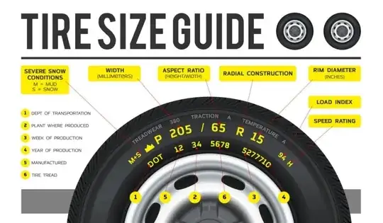

For tire size or rim size, you can crosscheck on your tires. Tire size guide
All tires have the size and spec stamped on the side. Which you can use it for reading the size of the tire and rim. So whenever you want to change the tire just look at your old tire and match it. (Unless the old tire is somehow using the wrong size?)
