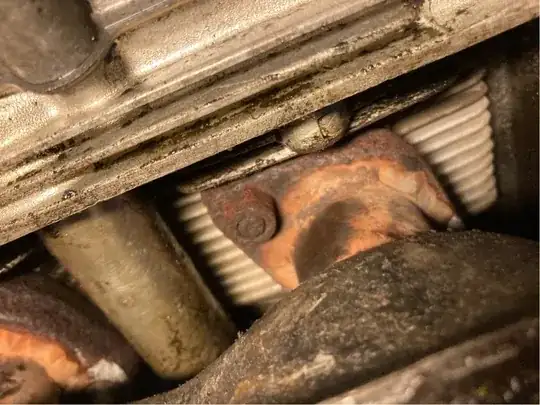

I have a 1982 Porsche 911 and need to remove the heat exchanger on one side. It's held on with three 13mm nuts and 3 barrel nuts. The barrel nuts were no problem, but two of the 13mm nuts are so corroded that the 13mm wrench doesn't fit them and a 12mm is slightly too small. These are hard to get to, so I only want to do this once. What's the best way to attack these without rounding them and making this an even harder problem?
rusty heat exchanger nut
Also I should mention that the way to reach them is with a 75 degree offset box wrench; I can't get a socket on them. I have also soaked them with PB Blaster.

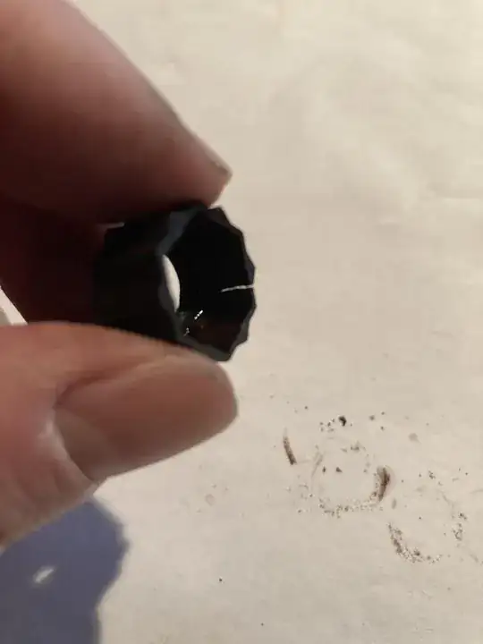

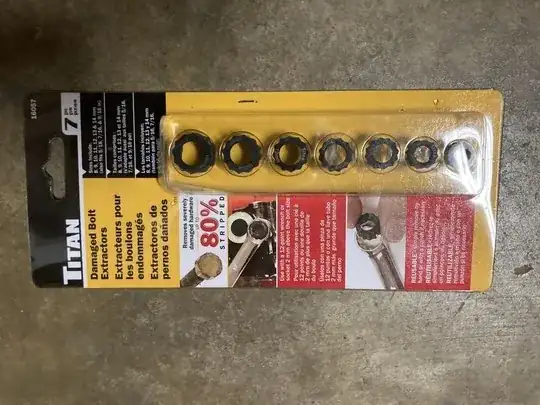

Thanks to you all for your many good suggestions, but I thought I'd share how I actually got these nuts off today. First, more PB Blaster, and then while I was at the auto parts store getting parts for another project, I spotted these and decided to try them: Titan Damaged Bolt Extractors
On the package they say "Reusable" but on the store's web site they say "Disposable" so my hopes weren't really high. However, I used it and it did the trick. Essentially, it's a 6-point adapter that fits into a 12-point box-end wrench 2mm larger than the target size. So for my 13mm bolt, I used a 15mm wrench. It's sufficiently low profile that it was able to fit where more conventional extractors probably wouldn't.
The result
broken adapter

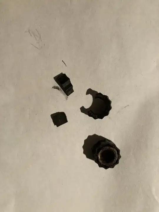

I tried the first one and was elated when it actually broke the nut free, so I tried it on the second one, where it promptly cracked into pieces. Still, it seemed to me to be worth the $10 that I paid for the set, so I went back to the store and bought another set. As you can see from the picture above, the second nut was also removed and was tightly lodged in the extractor. I was able to remove the nut eventually, but there is now a significant crack in the side of the extractor, which leads me to conclude that I haven't many uses left with this one.
cracked extractor
So my conclusion is that these are better thought of as "disposable" than "reusable" although some reuse is probably possible. Copious amounts of penetrating oil and the German opera on the radio probably both helped, but the tool did what I needed and I consider the price worth the avoided headaches of alternative means.

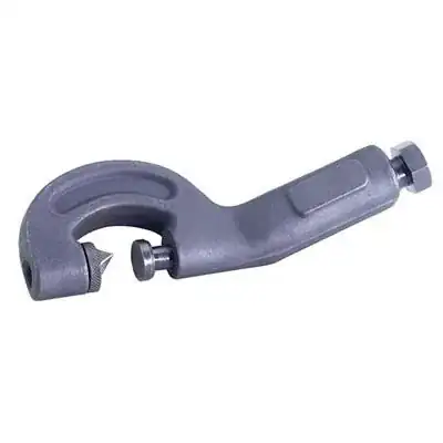

As you've noted, you can't get a socket over the nut, which eliminates a large number of tools with sharp internals that resemble a socket.
Not many options remain, but one of them is a nut splitter.
Summit Racing Equipment sells a nut splitter with an open arc. Many other nut splitters are enclosed circles, also resembling a socket, but the open arc allows you to approach the nut from one side.
nut splitter
Image gratuitously used from the linked site.
There are other sources for similar tools, this was selected for clarity of the image.

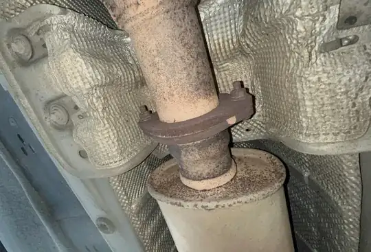

I just got a corroded 13mm nut safely off a muffler connection to the catalytic converter on my vehicle with some tips I could share your way.
I first hit it with a wire wheel to clean up surface rust, then I applied some Loctite Naval Jelly Rust Dissolver with an old paint brush. I let it sit about 10 minutes then sprayed it down with water collected into a catch bucket. I examined the nut and measured it with some calipers to make sure things weren't too far out of spec. The nut looked decent though the studs on the exhaust were pretty degraded and their threads corroded away a good amount. The metal looked in better shape than it did when all rusted, it was pretty superficial stuff so I knew at that point from visual inspection that the nut stood a good chance of being removed successfully.
I then sprayed the nut all around with PB Plaster and let it sit a bit. I then got a deep hex socket and a breaker bar and began to work the nut slowly back and forth just like this fella taught me in the video Old Mechanic Trick To Removing Rusty Exhaust Manifold Bolts!. You can feel the small crack sensations at which point you go back the other direction to tighten back down, and loosen, and tighten. You cycle back and forth till eventually the whole rust gives and you hear a pronounced crack and then you can back things up easily and if you need to tighten the nut back down to do any remaining stubborn nuts that need to be removed.

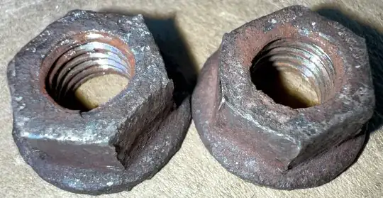

I initially tried to feel it out with a long offset wrench but it was a 12 sided box end and it just had too much slack for comfort--it would have rounded that rusty nut for sure. The hex socket also had a bit of slack and extra margin it felt like, when doing the back and forth cycling you can feel the socket forcibly remove from the nut and do likewise on the opposite half almost like they were glued together or something. You can see the creeping of the rounding on the removed nuts in the last image below.
Here's a few photos of the nuts installed and as removed
Muffler Flange wide view
Muffler entry pipe flange to catalytic converter exit pipe flange showing the layout of the nuts in situ
Rusted muffler flange nut closeup
close up of the rusted muffler flange nut
Removed muffler flange nuts closeup
Notice the sharp vertices of the nuts. You can see the material starting to round but pushed back as I did the opposing torque to break the rust free. enter preformatted text here close up of removed muffler flange nuts
