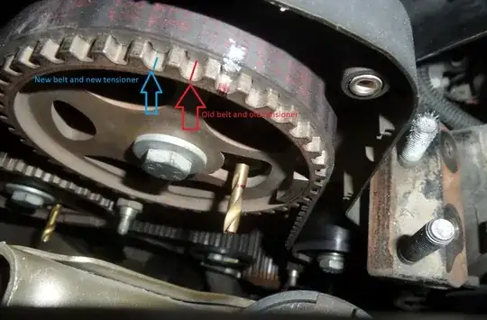

Recently, I replaced my timing belt, water pump and belt tensioner. Everything looks fine but I noticed something. With the old tensioner (17 years old), the old belt would sit at slightly different position on the pulleys. I mean when I tensioned the old belt with the old tensioner and cranked the engine by hand (to take up belt slack), the belt walked a little more and sat on a different position on the pulleys but with the new belt and new tensioner, the belt walks a little less before sitting in its place. The following picture shows belt location on intake pulley (with the old and new tensioners).
Should the new belt sit at exactly the same position on the pulleys with the new tensioner like the old set up? Is this normal that the new belt walked less than the old one after cranking the engine by hand? New belt tensioner has been installed and tightened properly like the old one.

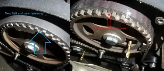

This is a side by side comparison:

The new position looks like it is more correct than the old position, which looked too far back.
Looking at the location of the tensioner, wear would likely cause the tensioner pulley to tilt up at the front, which could cause the belt to move back on the pulleys.
Was there much play in the old tensioner?

Lets sum it up:
  1. You used the right parts.
  2. The pulleys are synced.
  3. The tension is correct.
  4. All the bolts are tightened.
  5. The belts rests at the correct position onto the pulley.
  6. You checked the alignment of the tensioner pulley.
  7. After several revolutions of the crankshaft by hand the points above are still correct.
If all the points above are matched, then I'd consider this job done correctly.
The fact that the camshaft pulley settles in an slightly different position I'd consider as irrelevant. Maybe it is a sign that the old and new tensioner bearing have different running resistance, either the old one was worn or the new bearing needs some run-in. Maybe the old belt became stiffer. Maybe the new belt has a slightly different stiffness. Perhaps there was some misalignment of the tensioner before (that your engine survived by some miracle) and you corrected that. In the end it is irrelevant.
