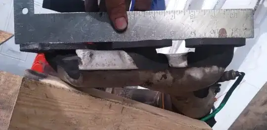

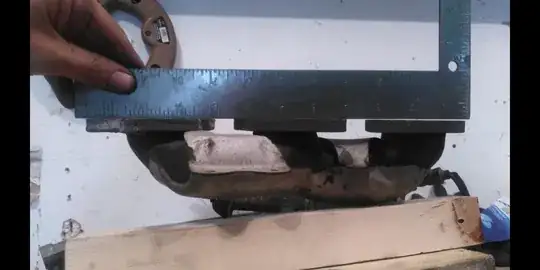

In your images, it appears the right flange is lower that the other two. The reason I say this is because in the second picture, the left and middle flanges are level to your square with the right one being lower. In the third image, there is light between the left side of the center flange. This means it isn't in line with the right flange. With that said ...
The best/cheap way for you to get your manifold in good shape is to bond sandpaper to a flat piece of thick wood, then sand the manifold flat. You have to be careful when doing this to ensure you're hitting the high flanges (in your case the left and center flanges). Check your progress regularly with the square to ensure you're getting the desired outcome.

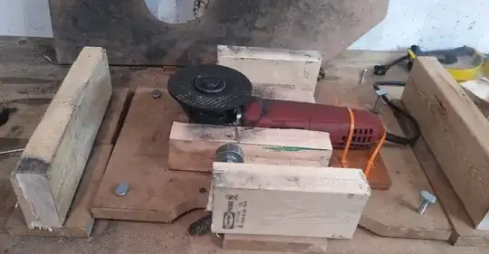

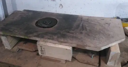

I think I have the situation under control. I made this rig with my angle grinder and got it a lot flatter. I need to finish it up in the morning but I at least know it works. The four bolts on each corner go into a threaded insert in the wood and are supposed to make it easy to dial in the orientation of the grinder but it doesn't work very good so keeping it level is a real pain in the ass. Pardon my french. Anyways a little TLC and I think it'll be fine.
These pictures don't do it justice. It's awesome, trust me.
