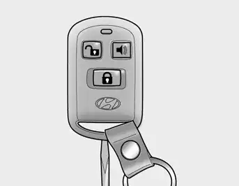

I have a 2005 Hyundai Elantra. This morning the battery on my wireless key fob died, so I'm unable to use it to unlock the car. From past experience, I know that unlocking the car using the physical key will set off the alarm.
  • How can I turn off the alarm after unlocking the car with the physical key?
  • Should I be able to replace the battery in the key fob myself, or will I have to take it to a dealer or somewhere else?

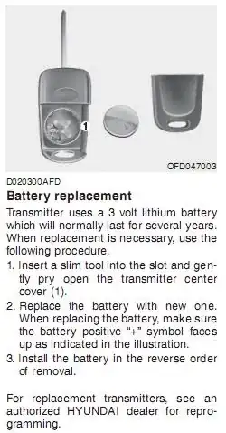

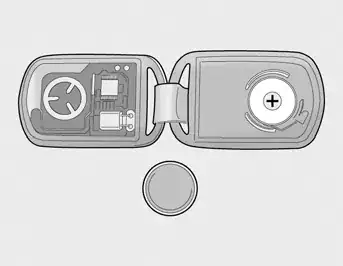

As far as battery replacement the owners manual also addresses that.
Replacing the battery
When the transmitter's battery becomes, it may take several pushes on the button to lock or unlock the doors, and the LED will not light. Replace the battery as soon as possible.
Battery type : CR2032
Replacement instructions:
Carefully separate the case with a blade screwdriver as shown in the illustration.
Remove the old battery from the case and note the polarity. Make sure the polarity of the new battery is the same (+side facing down), then insert it in the transmitter

According to the instructions, the battery is a simple CR2032 battery, found anywhere you can find batteries (like Wal-Mart, or whatever). If there is a second transmitter, use it. If not, you can try opening the door with the key, then using the key in the ignition. This works in some vehicles, but once the alarm is hit, you know the deal. If you don't want to try this, you can probably find another battery around your house to use for the mean time, such as in a different key fob or in an unused computer (in the motherboard). This will get you by until you can get a new battery for your fob. When you pull the battery out of your fob, you will not lose the code or need to have the fob reprogrammed. It is made to stay paired, fob with the car.

Replacing the battery is really simple. You can use a flathead screw driver, and be gentle and it should be easy. This video shows how to do it. It should be fairly easy. DO NOT go to the dealer... They will charge you way too much for it, and then will find something wrong with your motor as well.
