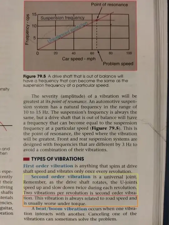

So after reading this section in my book Automotive Service 3rd Ed. by Tim Gilles I replaced the driver's side axle and the problem went away.
I suspect that when I recently changed the outer dust boot I may have damaged the inner tripod joint. Usually when I change an outer dust boot, I undo the inner dust boot and slide it out so I don't have to drain the transmission. Then I remove the inner joint to slide the boot up onto the outer joint. When I went to remove the inner tripod joint it was so loose that it actually when I removed the circlip it just fell off...
If I have time I'll inspect the old axle and see if I can verify anything and update this answer.
