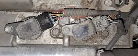

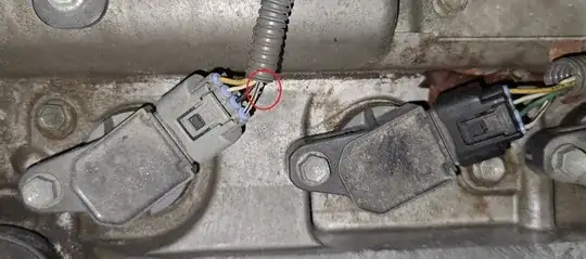

When I went home, I opened the hood, and first thing I noticed is that there weren't any rodent droppings that I can see. So I took pictures of the wires and applied some peppermint oil randomly which is something I found online that keeps rodents away.
However, I really didn't know what to take pictures off so I just took bunch of them plus a video of all the wires hooked to the engine. All the pictures are shared at the following link:

  • Repair Two Wires (Coil Pack 2 & 3) - Chewed $500+Tax (4H)
  • Plus Engine Shampoo $59.95+TAX
  • perform EFI & Throttle Body Service 199.90+TAX
  • Lubricate Propeller Shaft blots 39.05+TAX
Could anyone please help me in verifying if "Coil Pack 2 & 3" really need replacing?

The service center state coil pack 2 & 3 so it should/would be the two middle ones that need attention.
If you look at image 11 (20210923_203515.jpg) and 12 (20210923_203520.jpg) of 50 (see below).
Unable to get a clear view of 11 as it seems to be from the side/underneath. Inspect that one more. Possibly post a photo of it whilst unclipped, here is a video of how to unclip them (https://www.youtube.com/watch?v=p_pmMHvt10c). It just looks like the plastic has been bitten/slightly cut from the current angle, doesn't look like any wires have been slit.
Would this warrant a replacement? If the wires are exposed and none have been slit, I would say it does not warrant a replacement. If a wire or wires have been slightly slit and my engine isn't idling any different/not having any issues with the way it drives then no. I am assuming you have been driving it like normal without issues and this has just been realised at the normal service interval, so as it has been fine like that, it won't change unless you get corrosion/any other issues whilst leaving it exposed.
I would use electrical tape or maybe even some sort of sturdy cable harness on all 4 end points. The region where the wires are left exposed to keep them protected, in case of any vermin or service center foul play. I say service center foul play as the yellow slit wire looks like a clean cut, in my personal opinion. Who knows Covid has been hitting everyone hard, maybe vermin did bite the white wire as it looks plausible, the plastic being pushed outwards from pulling/bite? If one has been bitten what are the chances of a 2nd or 3rd, no one would know/assume any different?
You can always go to a different center for a second opinion to specifically diagnose those two ignition coil packs to see if there is any power loss/deficiency in the electrical current or whatnot. This could be way cheaper I reckon and peace of mind.
If the $500 + tax is for the parts and labour cost for replacing the two coil wirings. Now the question is what do they mean by that, are they going to strip the whole wiring harness and put a new wire from the start and end point, or will they link one up at the half-way point hidden in the other cable harnesses or what? As one would definitely not warrant a $500 + tax cost whilst the other possibly may?
