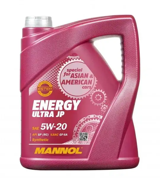

Is Mannol Energy Ultra JP 7906 5W-20 a good product? I can't find its complete technical data and freezing point. enter image description here

I can't tell if Mannol itself is good or bad (because it would be an opinion, which we don't do here), but by looking at the container image:
You can see it meets API SP and ILSAC GF-6A which are both the most current standards for motor oil.

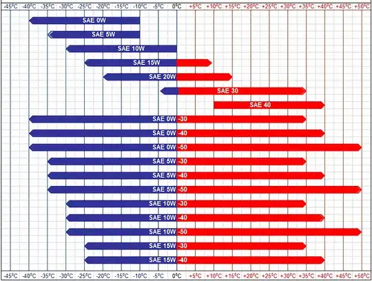

Mannol 5w-20 oil is a synthetic oil for Europe but has ratings for around the world. Your owner's manual should specify which oil but if your cold weather temps are below -35C then consider 0w-20 for -40C operation. enter image description here
