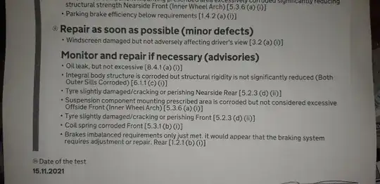

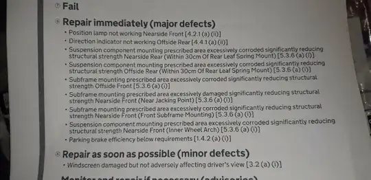

I found a van near me and it is cheap enough, but it failed the MOT on the things in picture below.
Is this vehicle to be avoided? I would need to pay someone to do the welding for me, is this job too much and should this van be at the scrapyard?

Note too, it only just passed the brake tests, a hint that you'll soon have to spend money there as well, perhaps a complete brake system replacement.
So no don't buy it unless you are an expert. The vehicle is "shot".

It is definitely going to need welding, rust has eaten through several areas and the only way to repair it is to cut out the bad metal and weld in replacements.
It's impossible to say how much work is involved, however translating the UK MOT weird jargon into normal human terms (nearside is passenger side, in this case the left, off-side is the driver side, in other words right) you can see that there's rust bad enough to fail in 6 places:
  • Left rear suspension mounting
  • Right rear suspension mounting
  • Front right subframe
  • Front left subframe jack point
  • Front leftr suspension mount
That sounds like a hell of a lot of rust, and the front right sounds like Swiss cheese. Although I cannot say with absolute certainty from an MOT printout previous experience indicates that this is very likely an economic write-off if this is a cheap van, and that it would not be a smart purchase.

The corrosion could be a very small amount of work or a massive amount of work.
For the UK MOT, even the smallest hole within 30cm of a suspension component will be a failure.
You would really need to take it somewhere to get a quote, but the fact that there are numerous possibly small or large holes in important areas would suggest that it is not going to be a cheap fix, especially if it is repaired correctly so that it will also pass next years test.
