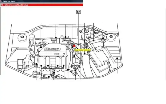

I have been searching the web for solutions to this problem, Most answers point towards the Idle Air Control valve needing cleaning/replacing - I am now trying to locate it in the engine I did find a diagram, however I am not sure if it is accurate.
How do I get to the IACV, or even better do you have a few pictures/video demonstrating how to access it?

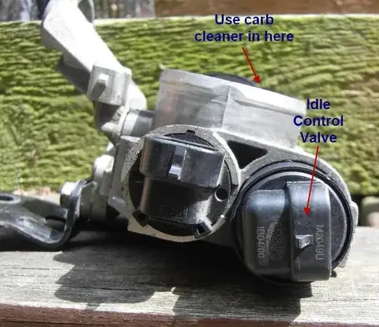

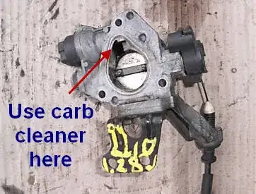

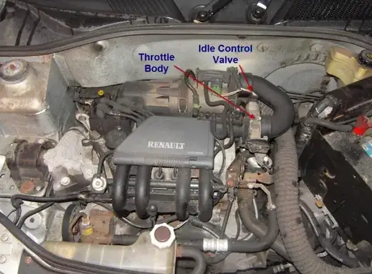

The idle air control valve is integrated into the throttle body unit as shown here:
It may not look exactly like that, there was an update some time around then but the parts are very similar and the principles are the same.
There is a forum thread with a few more pictures of the cleaning process here: http://www.renaultforums.co.uk/showthread.php?t=65279

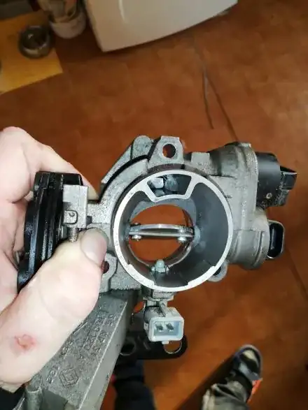

By the way, this:
the throttle is computer controlled and has no physical link to the pedal
is incorrect. This is me pushing the lever on my Clio 2 1.2 8V 2007 throttle that the wire that the pedal pulls actuates:
Clio 2 throttle body with open throttle
As you can clearly see, the throttle butterfly valve is open because I push the lever. This means that the throttle pedal actually does have a physical link to the throttle valve! The only thing that is computer controlled is the idler valve, but I don't know how you would move that, since it is pretty hard to get to and spring-loaded, so if you move it, it will go back to the original (closed) position anyway. Anyway, even those computer-actuated throttle valves actually are spring-loaded too. And if your throttle is computer-actuated, you probably do not have any idler valve, because the computer does the same with the throttle valve.
