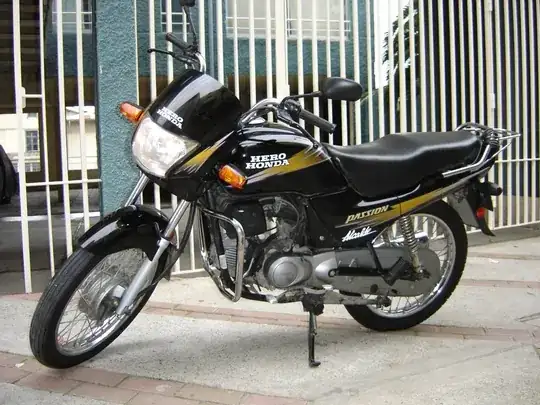

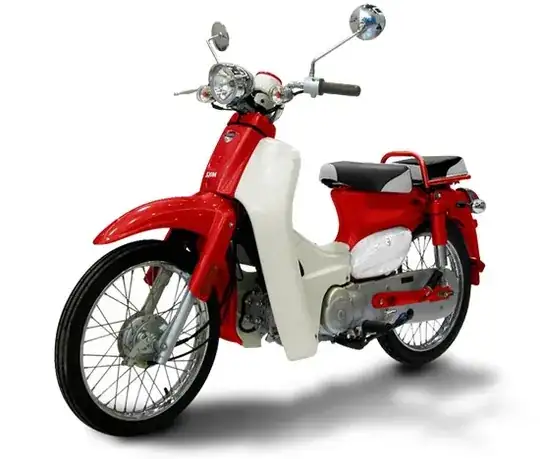

I notice that except for small commuter bikes and older bikes (before the 80s), hardly any of the larger and/or sportier bikes have covers to protect their chains: Honda Cub. Hero Honda Passion
They seem quite practical, and conducive to chain life- by protecting the chain from the elements and requiring less frequent lubrication. Then why don't larger bikes have them? Is it purely for aesthetic reasons? Or is there a safety aspect as well? Are there other reasons? What would happen if the chain broke in a bike with a chain cover?

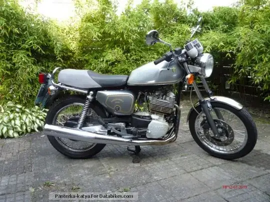

i think modern motorcycles don't use full chain covers only for sporty looks. Because in the 50-80ties many bikes had them for very practical reason. enter image description here Fully covered chain simply doesn't collect any grime and sand which mixed with oil stuffs everything with black goo eating away the drivetrain even faster then completely dry chain. Bicycle racers often run dry chains especially in enduro trails so they are not wasting precious wats on dirty chain.
