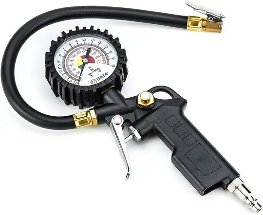

I have an air chuck similar to the one pictured. The gasket in the chuck at the end of the short hose is missing so it won't seal around a tire valve and as a result, cant inflate the tire.
When I try to remove the chuck by turning the hex-nut-shaped point just below the chuck, the whole assembly just spins. I can't tell if the chuck is threaded on or if its some kind of compression fitting. enter image description here If anyone has any experience with these and can guide me on how to replace the chuck, or maybe even where I could find replacement little gaskets, it would be much appreciated.

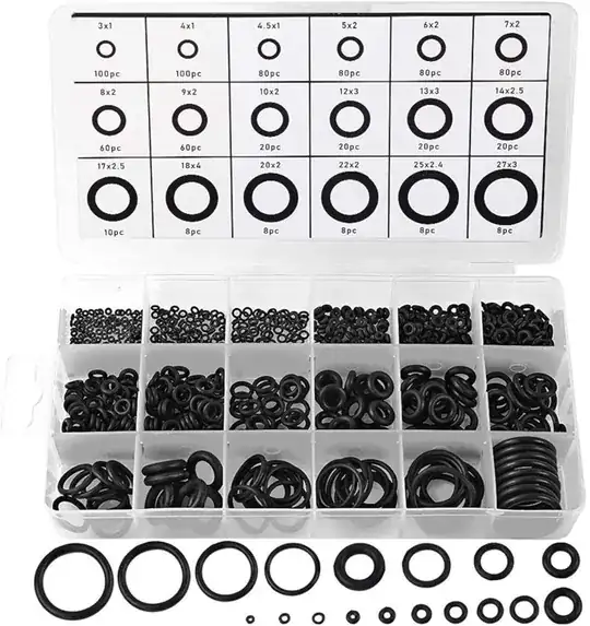

Your first option is boring - get an assortment of O rings and see if any of them fit the need.

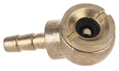

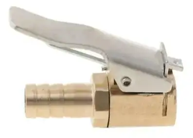

You could get a barbed air chuck in the same style, or one that has more of a bicycle-style of latch, or even one that you just hold in place.
You would cut the compression fitting off cleanly leaving as much hose as possible.
Slip a suitably-sized jubilee clip / hose clamp over, then ram the barbs up the hosepipe. It may help to soak the end of the hose in a cup of boiled hot water to soften it. Don't use gas or flame. A hot air blower may help but they tend to scorch. Hot water is best.
Last, wrap the clamp in electrical tape or heatshrink so it can't catch on anything.
