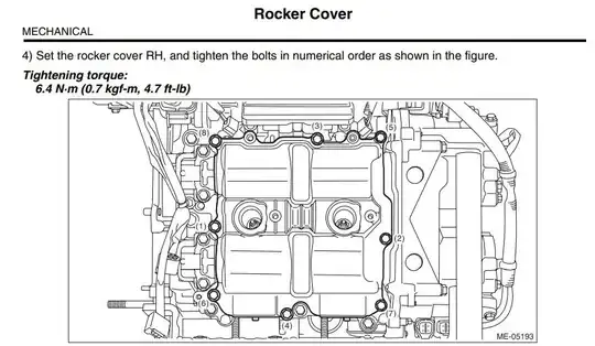

What is the proper torque sequence for a Subaru valve / rocker cover that has an 8 bolt pattern?
derelict
  • 283
The sequence shown below works for the (XV) Crosstrek, Impreza, and Forester (and possibly others) if it has the 8 bolt pattern for the valve cover. Tighten in order from 1 to 8.
Good videos for reference: https://youtu.be/nB-ls4cUkic and https://youtu.be/evk8PNZG8c8
