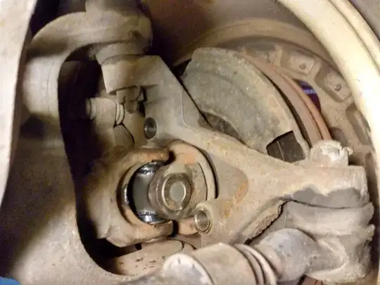

I replaced the front axle (steering) U-joints in my 1997 Jeep Wrangler, as one had gotten loose. The other looked okay, but when I pressed it out, it was rusty on the inside as well, so not far behind. Anyway, that job went well enough, and it all went back together nicely.

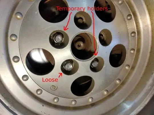

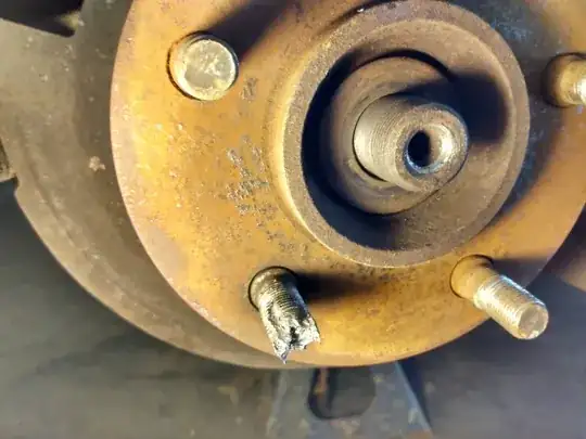

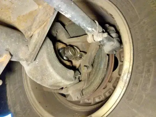

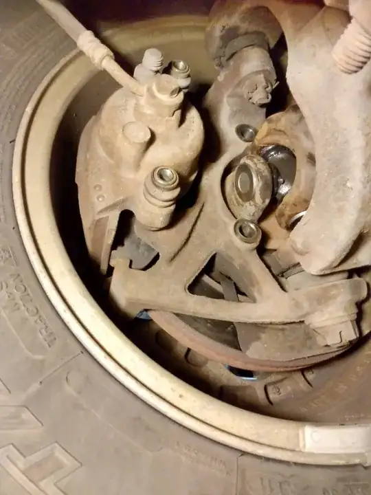

Instead of zipping off like the others, one of the lug nuts turned only a few times and jammed. In trying to un-jam it, the stud came out of the hub, with the nut still seized on it.
So now I have, essentially, a "too-long rivet" holding the wheel captive. I can't take the brake caliper off because the wheel is in the way, and I can't take the hub back off because the brake caliper is in the way. Or at least that's how it appears to me.
Pictures (brake caliper and hub bolts removed):
3-second wiggle: https://www.youtube.com/watch?v=0ZBS6MZStnQ
There's this answer to a similar question, that says to protect the area and drill the nut out. Then remove the wheel and repair the stud as usual. I can see that working, but is there a way to do it that doesn't risk collateral damage or wear out an expensive (big) drill bit?

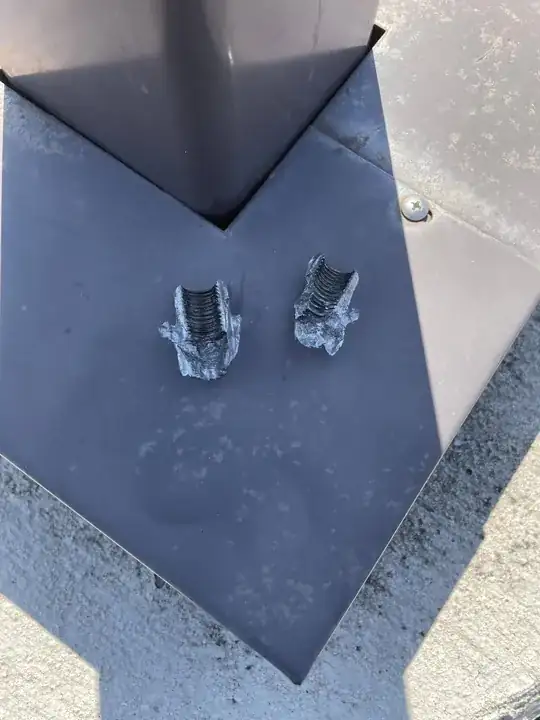

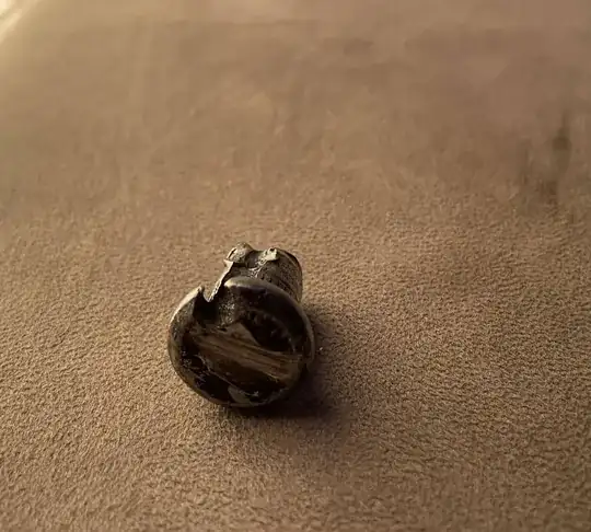

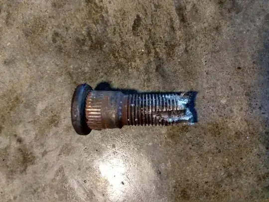

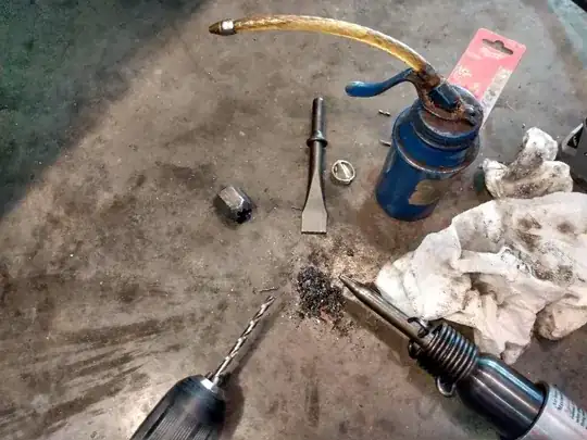

What seemed to work best was to use an air hammer with a round pointed chisel, first as a center punch for a small-ish drill, and then as a wedge to expand that hole further. Do that all the way around the edge, so it annihilates the threads, and it eventually came off.
(I set it back in for this picture. The air hammer kicked it out as soon as the nut let go.)
Try to drill in parallel to the stud, so that it does attack the threads all the way down.
It also helps to wedge something between the nut and the recess in the wheel, so the drill doesn't just spin the whole assembly. A large-ish punch works well, and just a few taps with a hammer is all it needs. You only want to have it there, and to not fall out, not necessarily pushing anything.

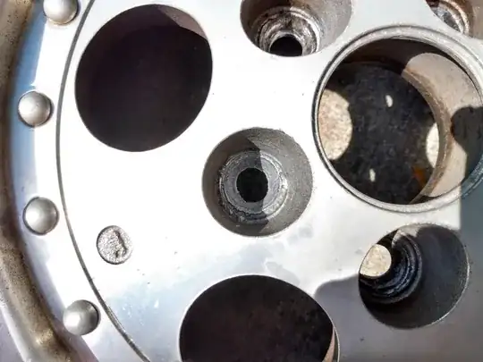

And here is what the wheel looks like afterwards. Cleaned up, of course. There was a mess of oily chips in it when I finally got the nut loose.
Looks like I might have just nicked it a little bit with the drill, but not enough to make a difference.

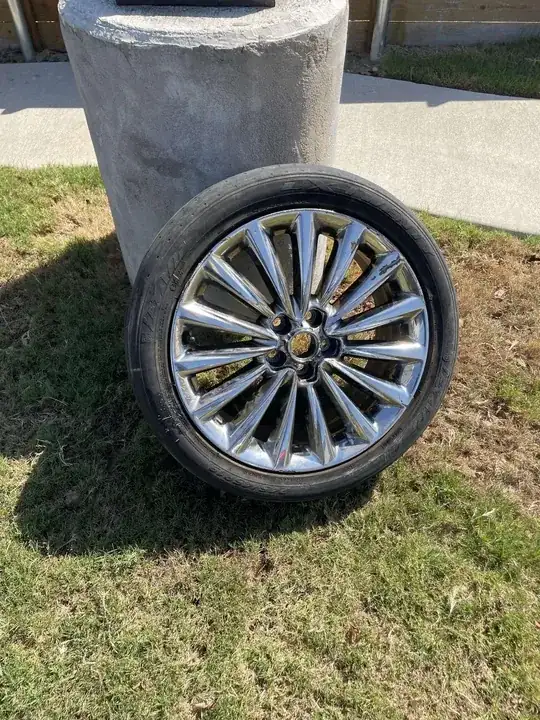

I wanted to add my story to the pile. I had this same problem, with my Kia k900, which has the recessed lug nuts, making the use of a nutcracker impossible. (The nuts are set too deeply into the wheel to be able to access them from the side, whatsoever.) It's a long story and I will spare some of the details, but first I tried on my own to drill it out, and after a few hours and a bunch of drill bits, I thought I was finally onto something when I broke one of the bits off with what felt like an irretrievable finality, so I gave in and called a tow truck. The first place I towed it to told me that the rim would have to be cut off using a grinder and that they couldn't help me with that. The second place I towed it to told me that they charged $150/hr and it would likely take 4 hours to cut the rim off with a grinder, and mercifully the guy also told me I was probably better off dealing with it myself if I wanted to avoid paying minimum $600. So I had it towed home. Thanks to AAA, all three tows cost me only $55. The key that saved me in the end after some internet research were the cobalt drill bits. That and a nice heavy hammer I got from Home Depot. But the cobalt bits really made the difference. Oh, and the WD-40 -- was integral in marking my first incremental victory which was extracting the drill bit I had initially broken off in the hole. That was the first moment when I felt like I might actually prevail. It still took forever but I was able to drill it out at that point. You can tell from looking at the head of the stud (that was a bit of a pain to extract) that I had grown so fed up with the whole thing that I was a little over-zealous in the extent of my drilling. split nut drilled thru the stud wheel w/ holes for recessed lugs

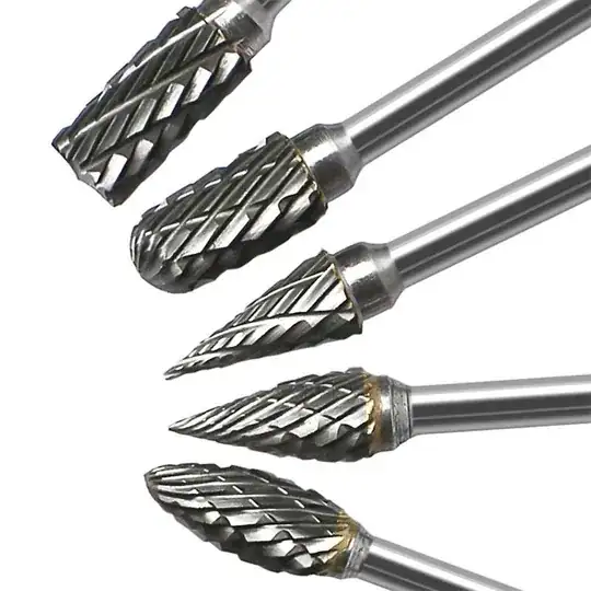

  2. Mill it out. Place in a protective sleeve, and get a die grinder with an tungsten carbide milling bit. Also get some cutting fluid and good personal protection (face shield or high rated googles, ear protection and gloves), as those mill bits are prone to breaking, and they are spinning at a high velocity.
The mill method is a dangerous method, the mill bit can jam between the nut and the rim, therefor I would prefer a weaker tool (perhaps a dremel).
